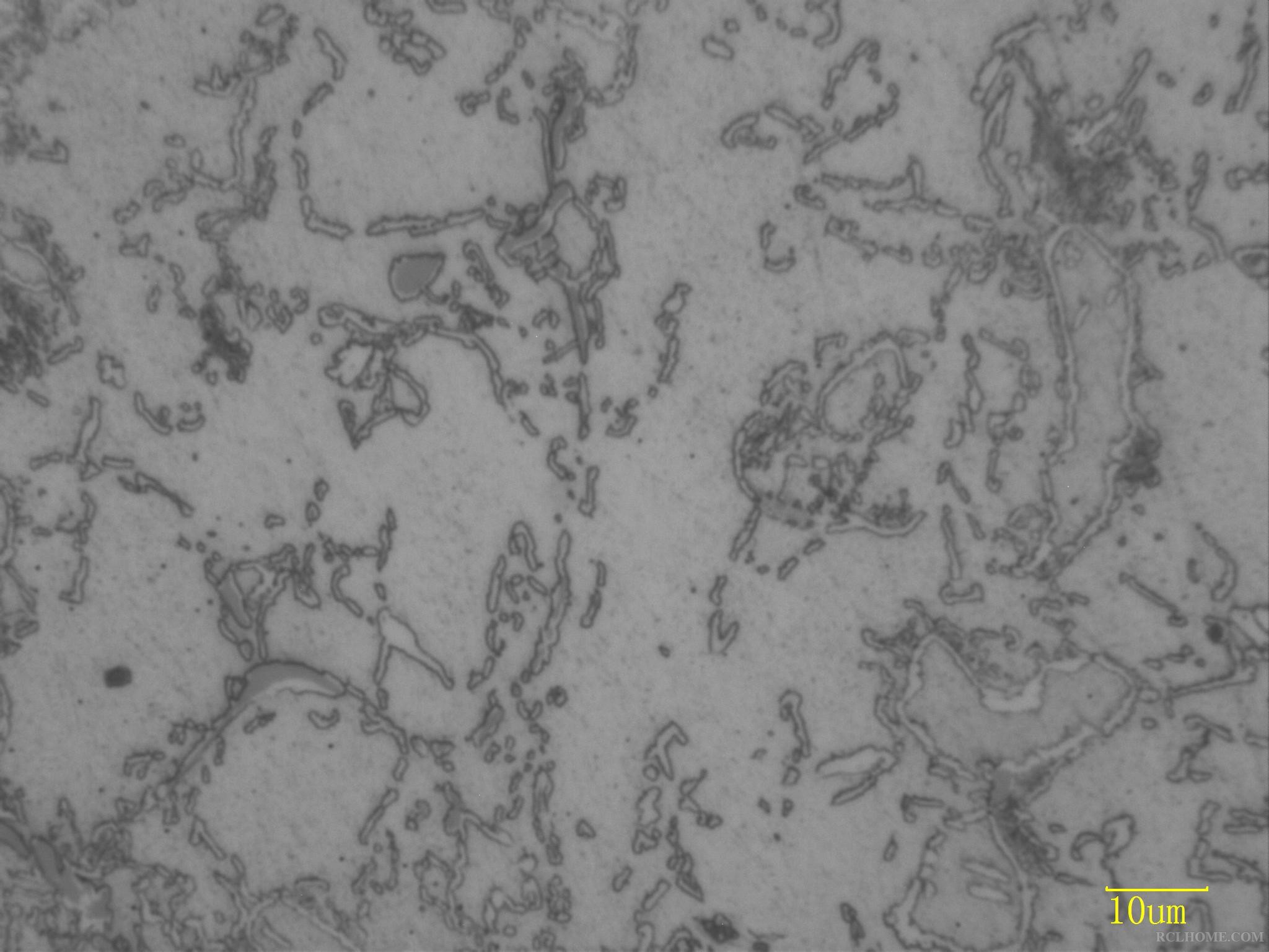

金相要求:
The microstructure of material made to this specification shall consist of a network of
chromium carbides plus some globular manganese sulfides dispersed in a matrix of
chromium ferrite.

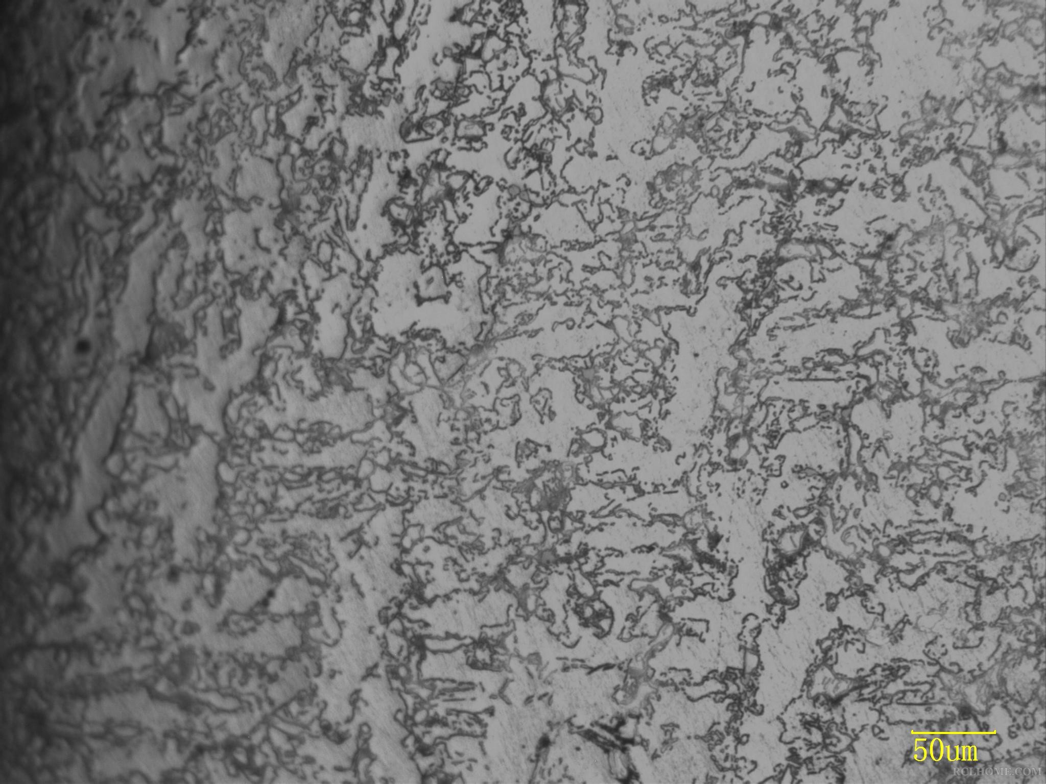

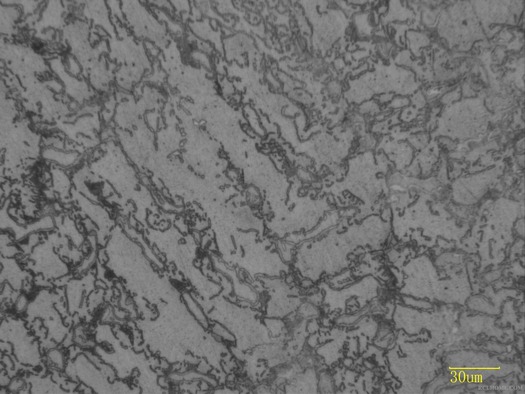

腐蚀后图片,如下

1000x图片上面,碳化物里面是什么析出的,怎么一张上面有,一边没有啊

再发张不要腐蚀的金相照片,那样可以看下硫化锰形态
