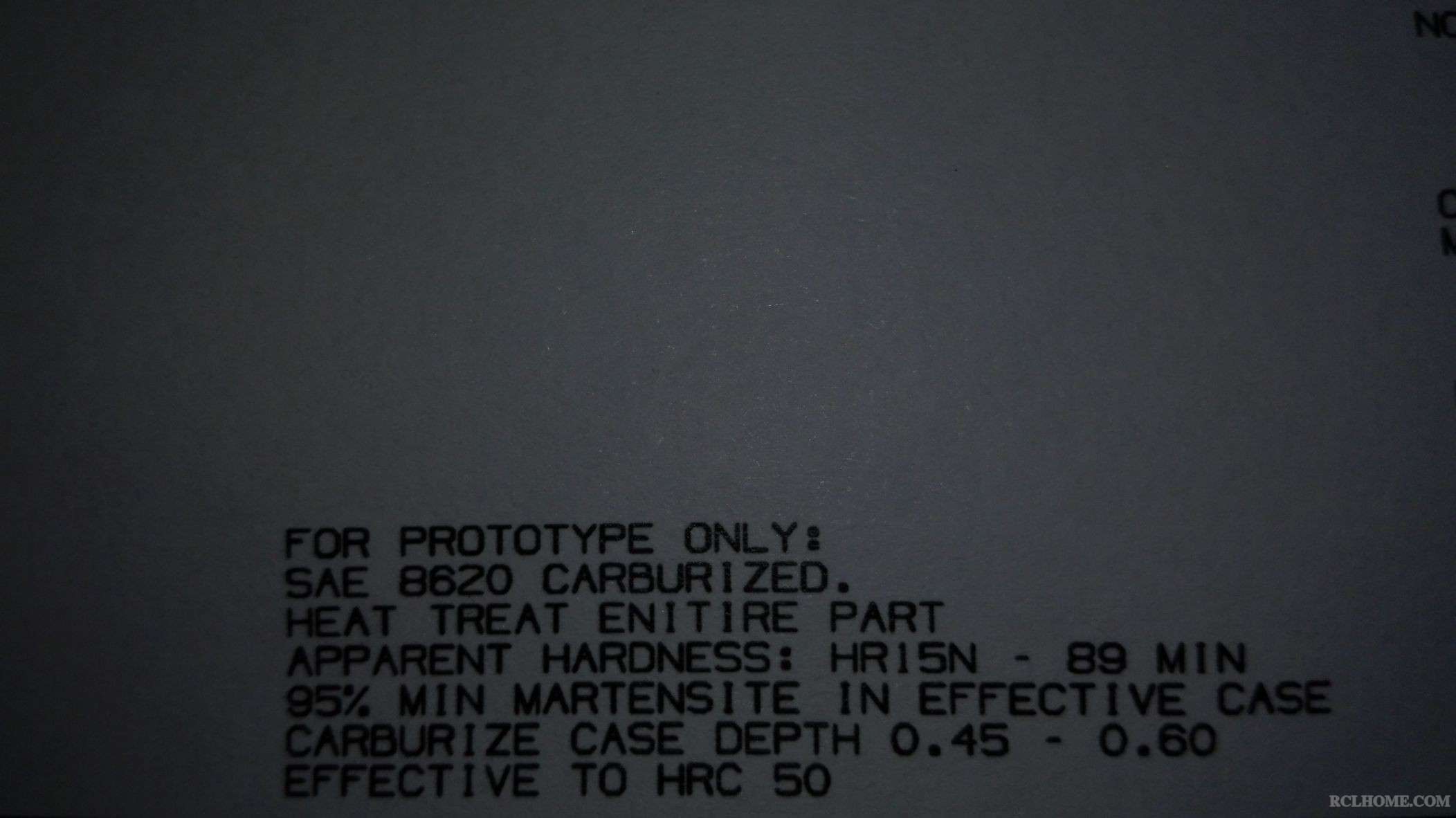

what is the apparent hardness?
发表于 2015-12-22 15:26:42 来自手机 | 显示全部楼层 |阅读模式
meaning is what.
发表于 2015-12-22 16:39:10 | 显示全部楼层
i guess it means surface hardness.

发表于 2015-12-23 11:41:36 | 显示全部楼层
   looks like hard  or  soft?

发表于 2015-12-23 14:21:49 | 显示全部楼层
Actually, it should be surface hardness
