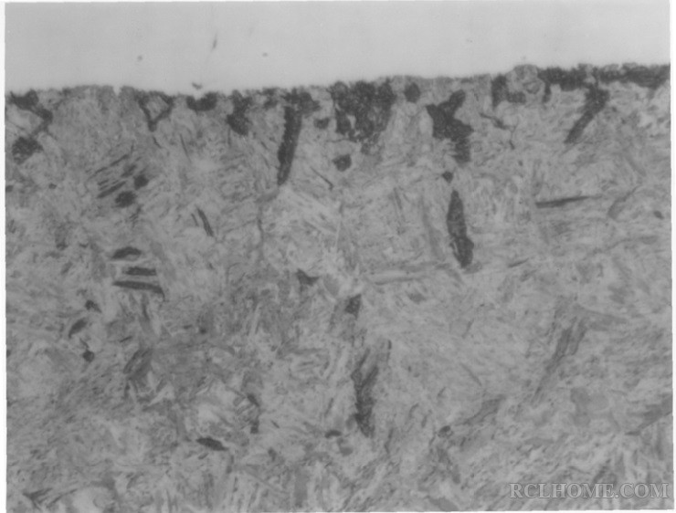

non--martensitic transformation products(非马转变组织): Inclusive
terminology for ferrite, cementite, pearlite, and
upper bainite in the surface microstructure of
carburize hardened gearing due to incomplete
transformation to martensite. See figure 10 for a
photograph of non--martensitic transformation products
in martensite.
哪位朋友翻译一下哈,让杨工也看看

你这看的是agma的标准上面的吧,后面的一段话侧重upper bainite!
